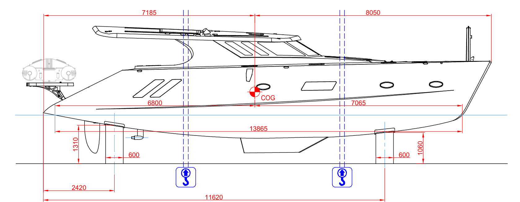

Good morning,
Does anyone have a blocking diagram for a 480 or 500? We are getting hauled and I want to be able to see the keel as much as possible, so I asked the yard to put us as high as possible.
Carol
“Jewel” hull # 67
The two diagrams I have for the 500SE
K500se Lifting and transport plan.pdf (3.6 MB)
K500se Trailer Bearers Positioning Drawing 2.pdf (651.4 KB)
Comment from KYC support when we first lifted…
“Yes, the boat’s keels are load bearing, but please be very careful with it. If they drop the boat on the keels, they will not be able to withstand the impact. Also, the centre of gravity is more towards the aft of the keels, and especially with your solar arch, the boat might want to lean backwards.”
