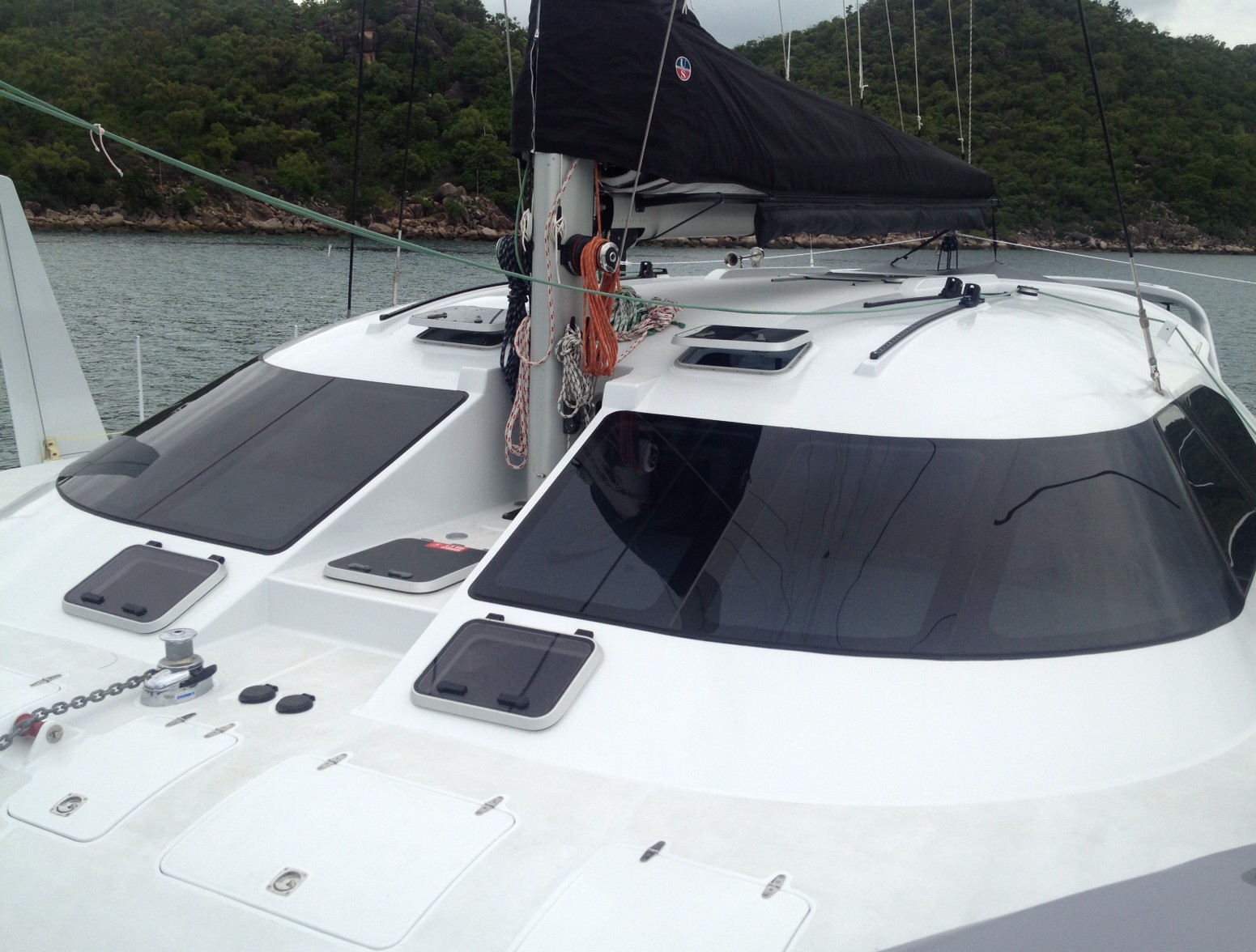

I’ll include a photo of a boat with plastic windows…
