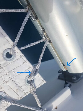

We have recently replaced our tramp bungee/line with dyneema all around, 2 years and the bungee had had it. It is not strung excessively tightly so there is still some movement - but much less than we had with bungee on 50% of the sides.
We tied each side independently just in case a line snaps or comes untied. We started each side with a Brummel locked eye in the end of the dyneema for each side and tied the ends.
The feel underfoot is I suppose personal preference - but we prefer the less bouncy more secure feel. As to how long it will last, only time will tell. One thing it does eliminate is the kids bouncing on the trampoline playground.
Note: we also had to have the stitching re-done on the tramps at this 2 year point too - it was average quality thread and had been completely destroyed by the UV. We have re-stitched with Tenara thread that should last much longer.
One thing to watch out for is the stainless sliders can come out of the end of the tracks and get lost - if you look closely in the photo you will see we blocked the end of the slider track with trimmed off wine bottle cork.
