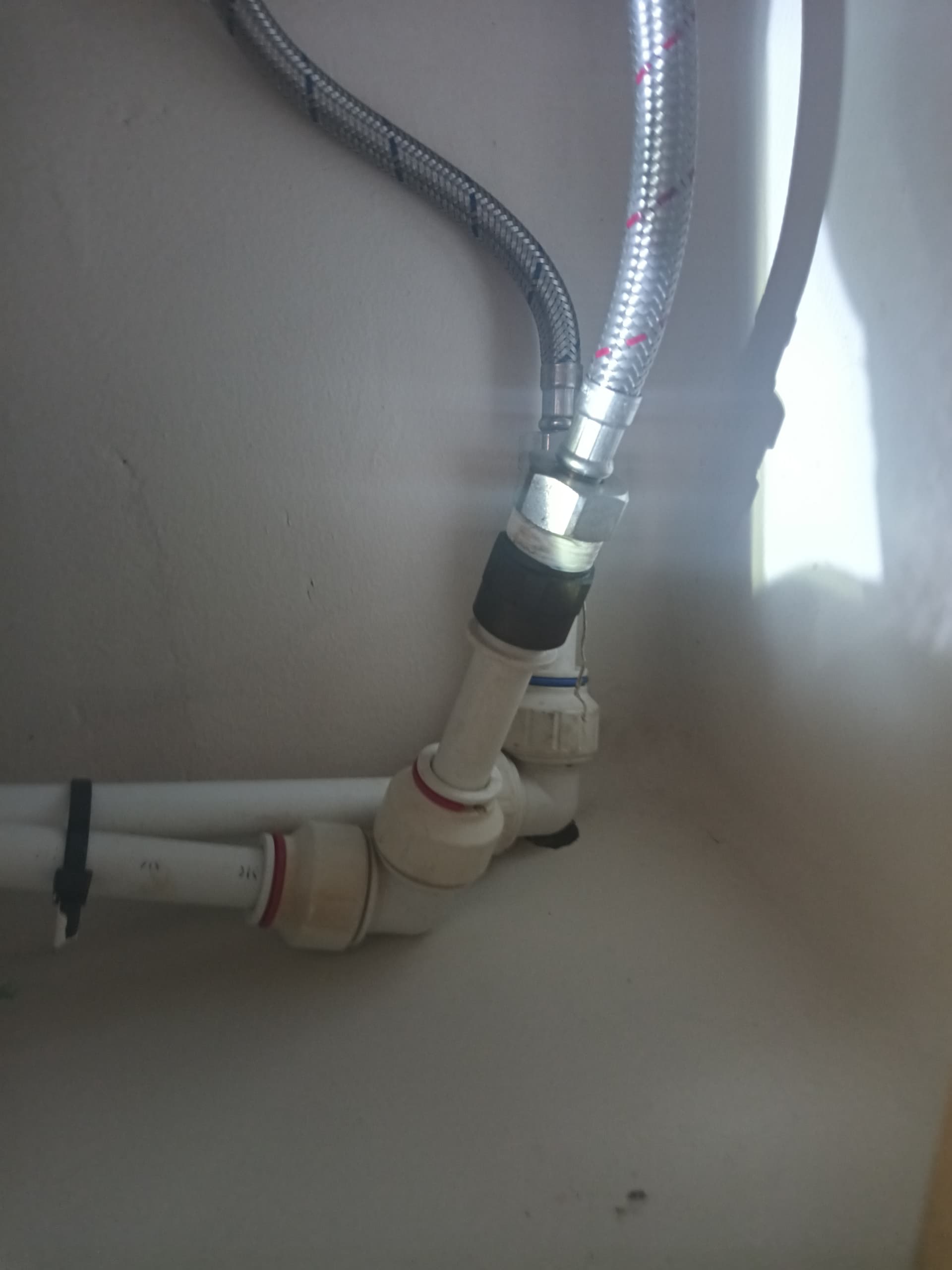

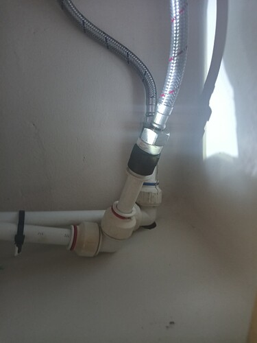

The toilet gets its water from a T under the sink. Remove that T and replace it with an elbow. Easy. The toilet is now isolated.

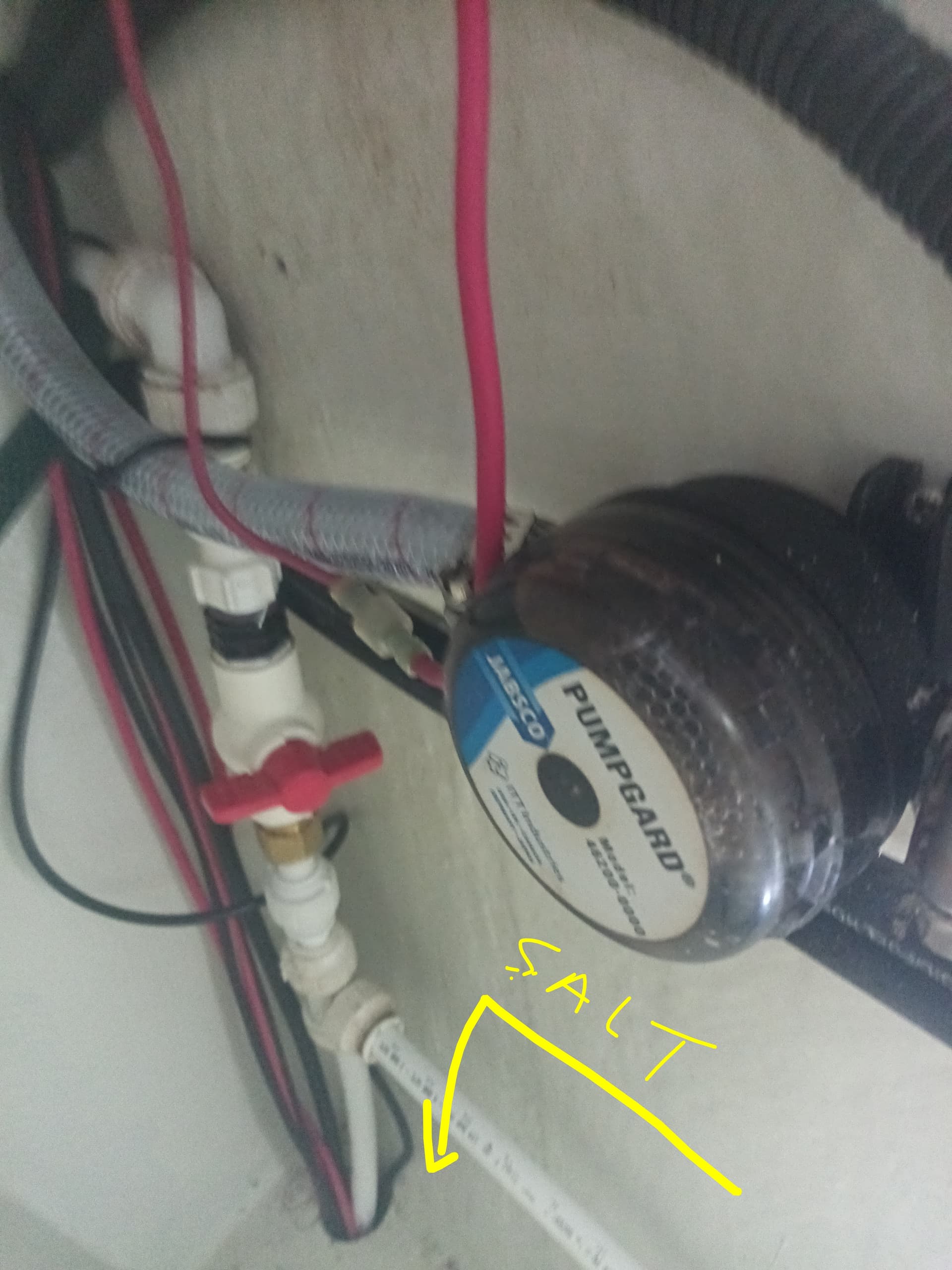

The red tap in the photo is the new tap. If it’s open, and the starboard pump is off, the toilet is fresh and supplied from the port pump. It’s closed and the starboard pump is on, it’s asalt water toilet.
The deck wash tap is either salt or fresh, what ever the toilet is being supplied with.
I kept the starboard fresh water feed, so I can supply the starboard pump with fresh water from the tank in case the port pump fails.
