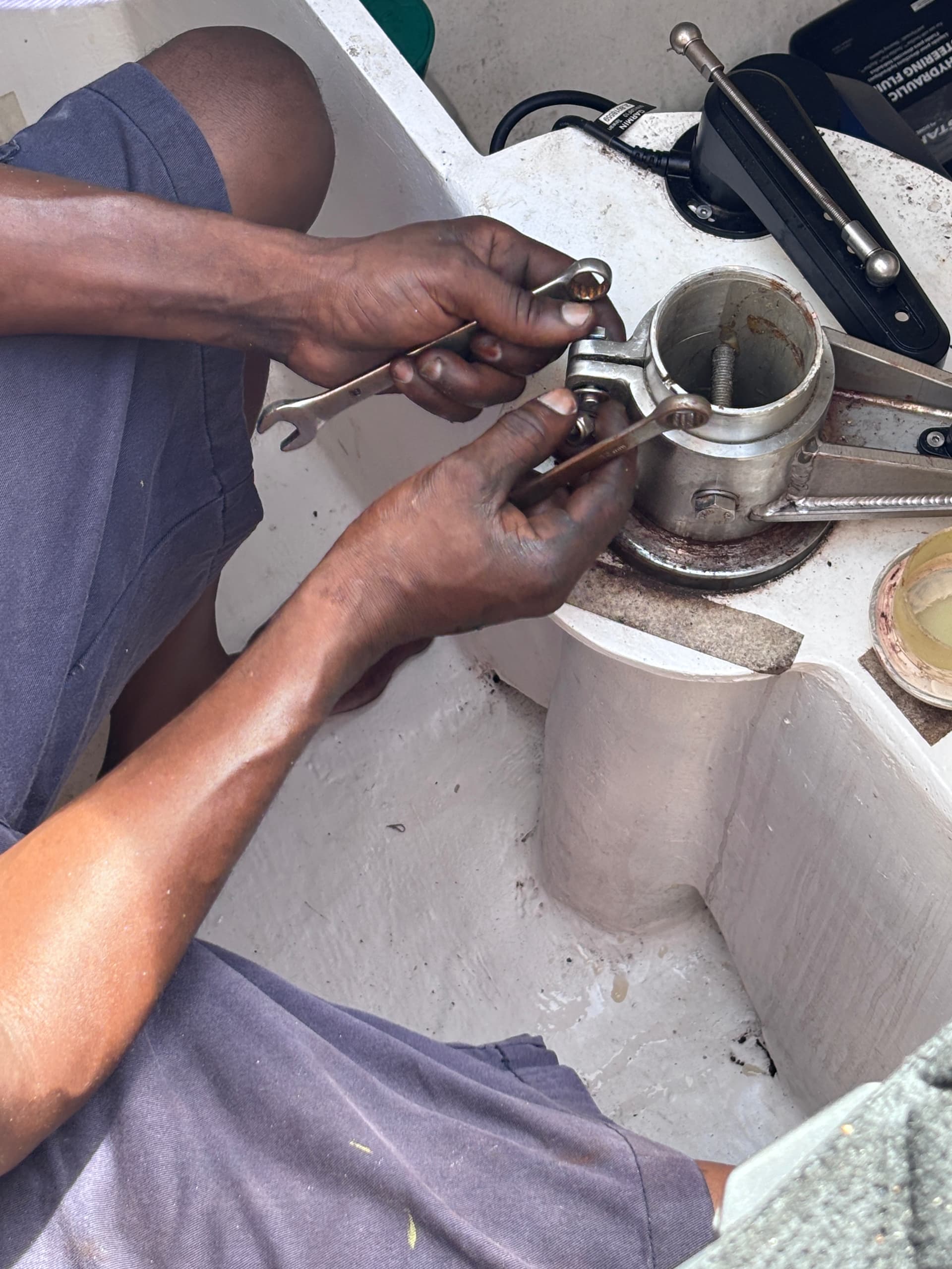

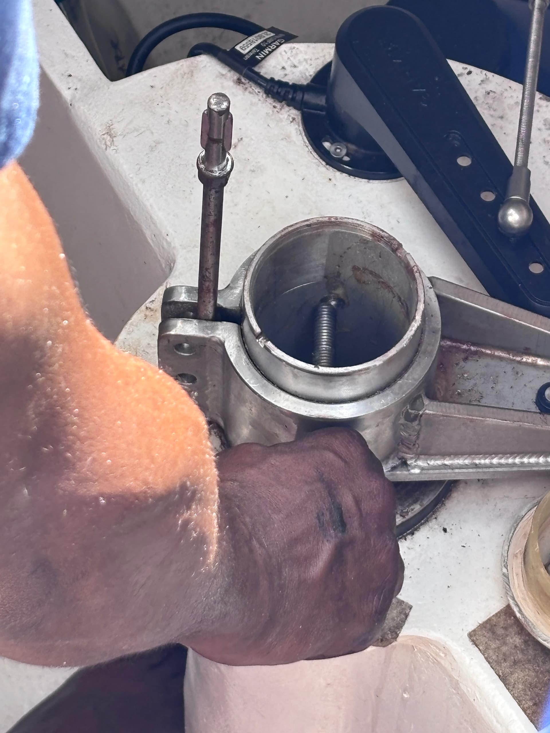

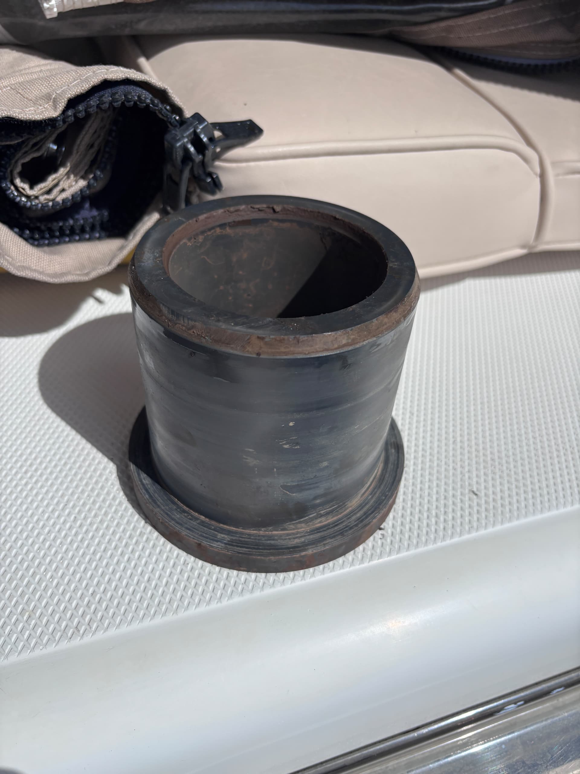

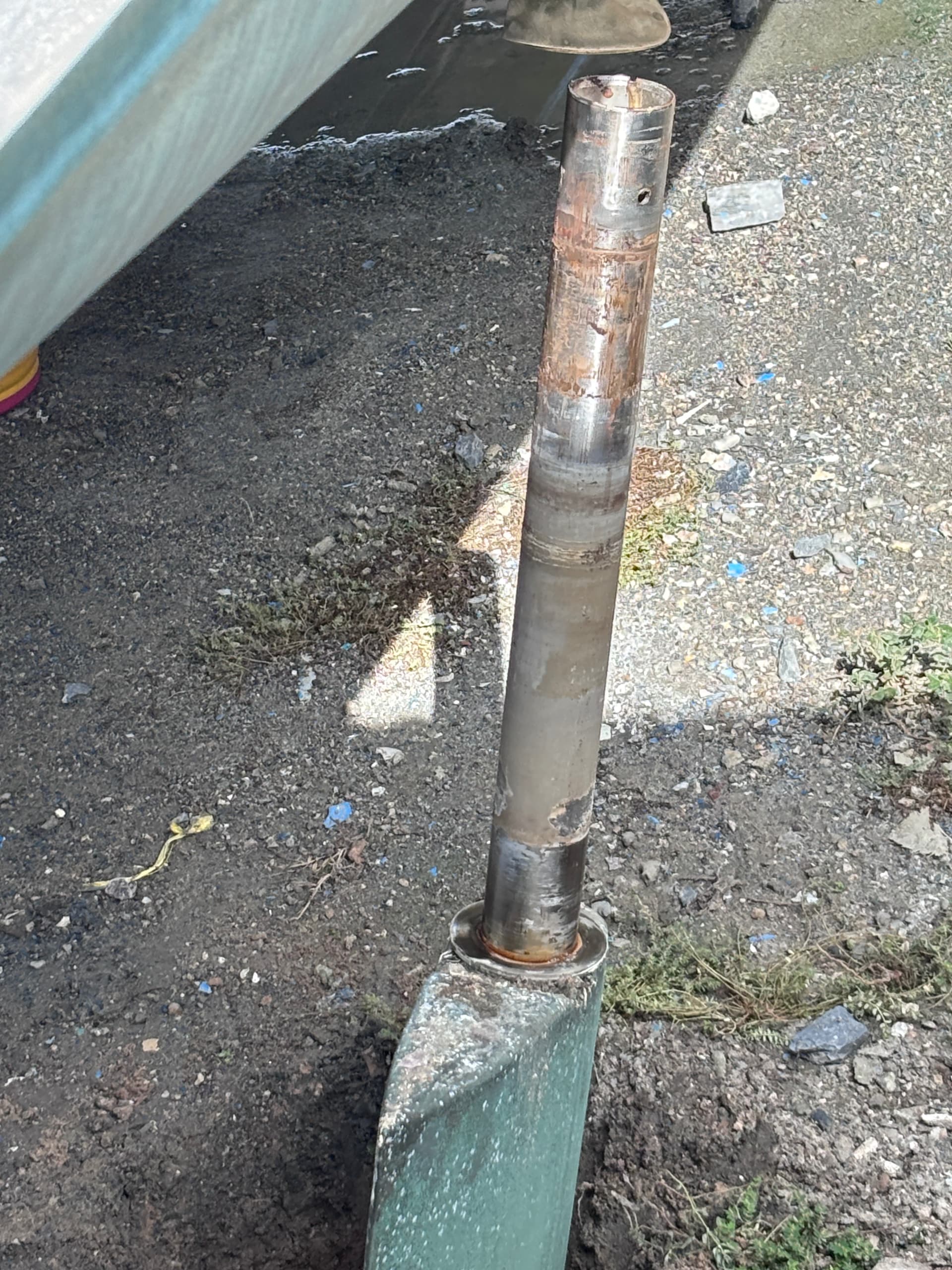

We are in Trinidad right now getting our “bearings” done. I’ll just post pictures of the event. Maybe they are helpful…
The hole in the ground for removal.
The “bearing”
