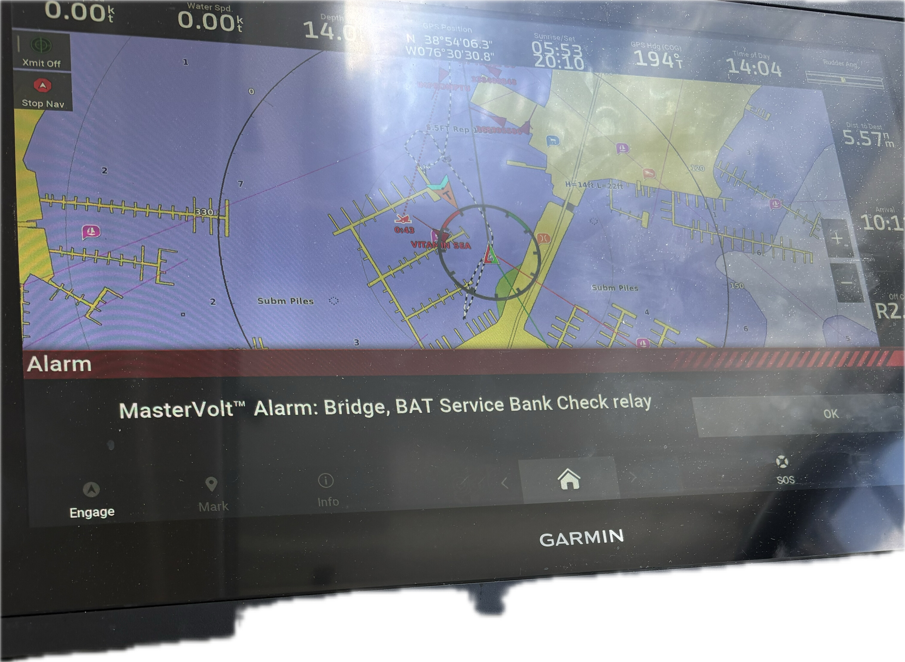

Relay location
Does anyone know where this relay is located ?
Tx

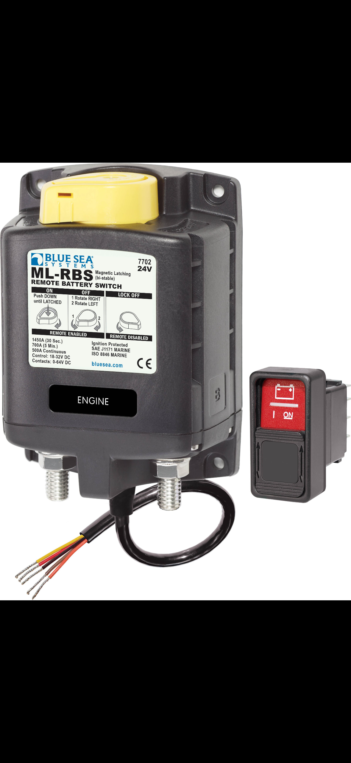

Plugged this into ChatGbt and said it is one of these. I would take it with a grain off salt but worth a try.
Thanks Don for taking a look .
You should find one of those automated Blue Sky relays for each battery. (And maybe one for the solar input too)
I found them difficult to tell if they had tripped - the button comes level with the top if it trips and given where they were located in the electronics locker I had to feel rather than look for the status.
Ours were controlled by the Master Bus Digital AC units.
I glued red neoprene on to the top of the buttons as a visual indicator if the button popped up.
