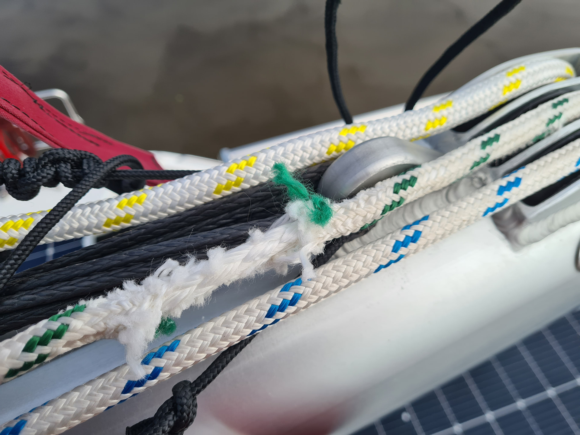

Tourterelles has had trouble with the reefing lines chafing on long passages since we bought her.
The boom has a lug to attach the sail outhaul that the 1st & 2nd reef chafe on - however this implies there is movement too. I am thinking that the standard lines the boat came with are basic polyester braid on braid and I am wondering if as the sail pulls - especially off the wind that the line is stretching inside the boom and causing movement at the chafe point - see picture.
Until now I have addressed the issue by putting a dyneema chafe protection sheath (tube) onto the line at the wear point.
But even that eventually fails…
I am considering changing the lines for a dyneema core+outer line that will have much less stretch and therefore movement.
Does anyone have similar issues and if so how have you solved them?
Any thoughts on the pro’s n con’s of replacing with dyneema gratefully received.

Thanks Steve, I think the reefing lines are tight when in use - I lift the boom on the topping lift, set the reef then lower it on the topping lift again.
The reason I posted was that a couple of days ago reef one chafe through completely (photo is from previous issues). When I reach Fiji I will fish out the remnants and work out where it chafed - I expected it to be the same.
For now, completing the passage on reef two…
