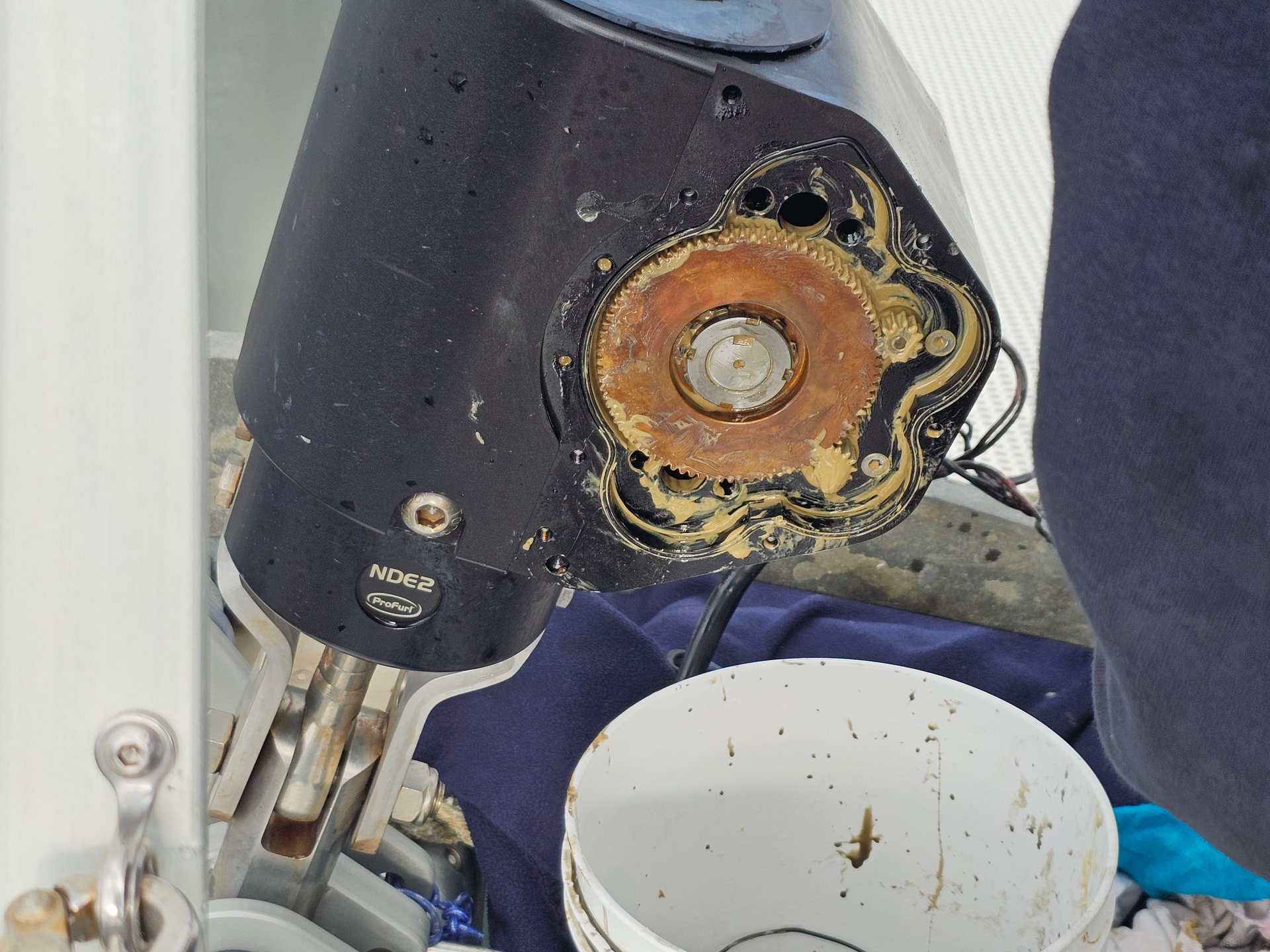

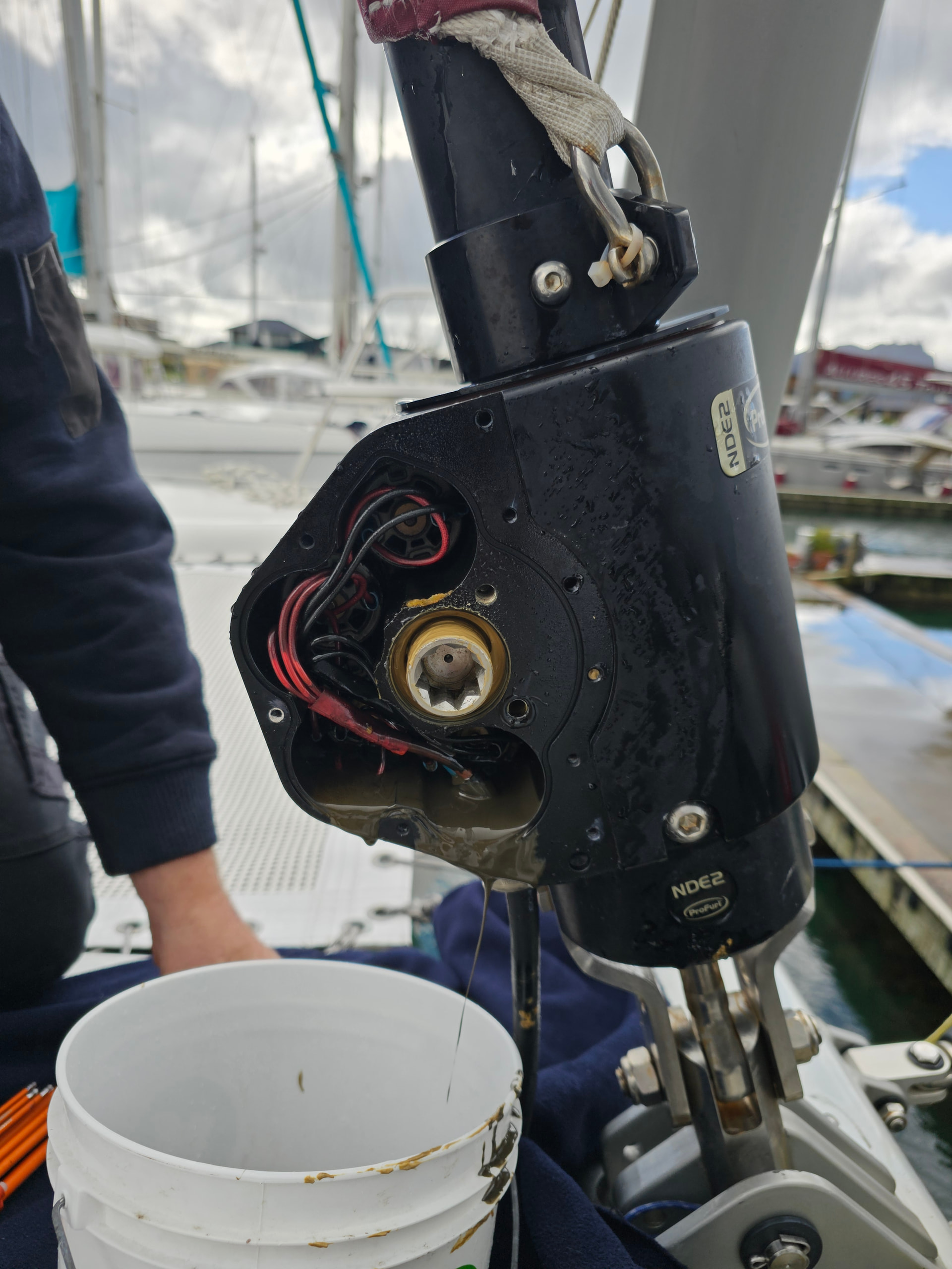

Our unit had let water in and the compartment with the electric motors had emulsified black liquid in it. Upon investigation the anodising is said to be damaged on the thrust tube leading to a poor seal and water ingress.

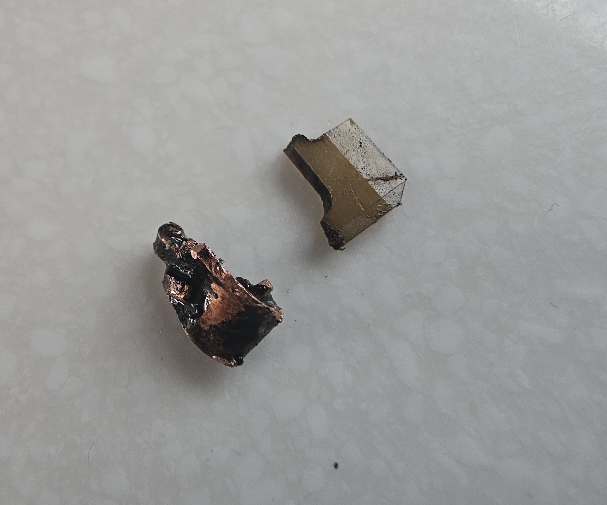

We also had some torn and damaged bits in the oil (see photo), I’m unclear why…
Verdict from “Kiwi Yachting” the NZ distributor was new motors, seals, bearings and a thrust tube were needed - a poor outcome for a 3 ½ year old unit.

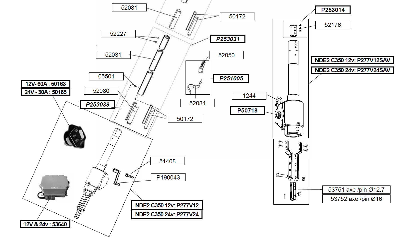

I’m trying to understand which part is the Thrust Tube, based upon this diagram:
I just did an overhaul of a white furler. What a job!!! ended vapor blasting, welding and machining the thrust tube. It was a big job. Poor sealing is the same issue as the white furlers are failing from. On the white ones, the seals cut through the anodizing, which allows the aluminium to come in contact with salt water. this gets pitted and cuts the seals. Then water just flows into the unit. Well, that is the white furler. In my opinion, if they were overhauled at about 5 years, they may last a lot longer. Whatever way you look at it, they are a poor product for the price.
