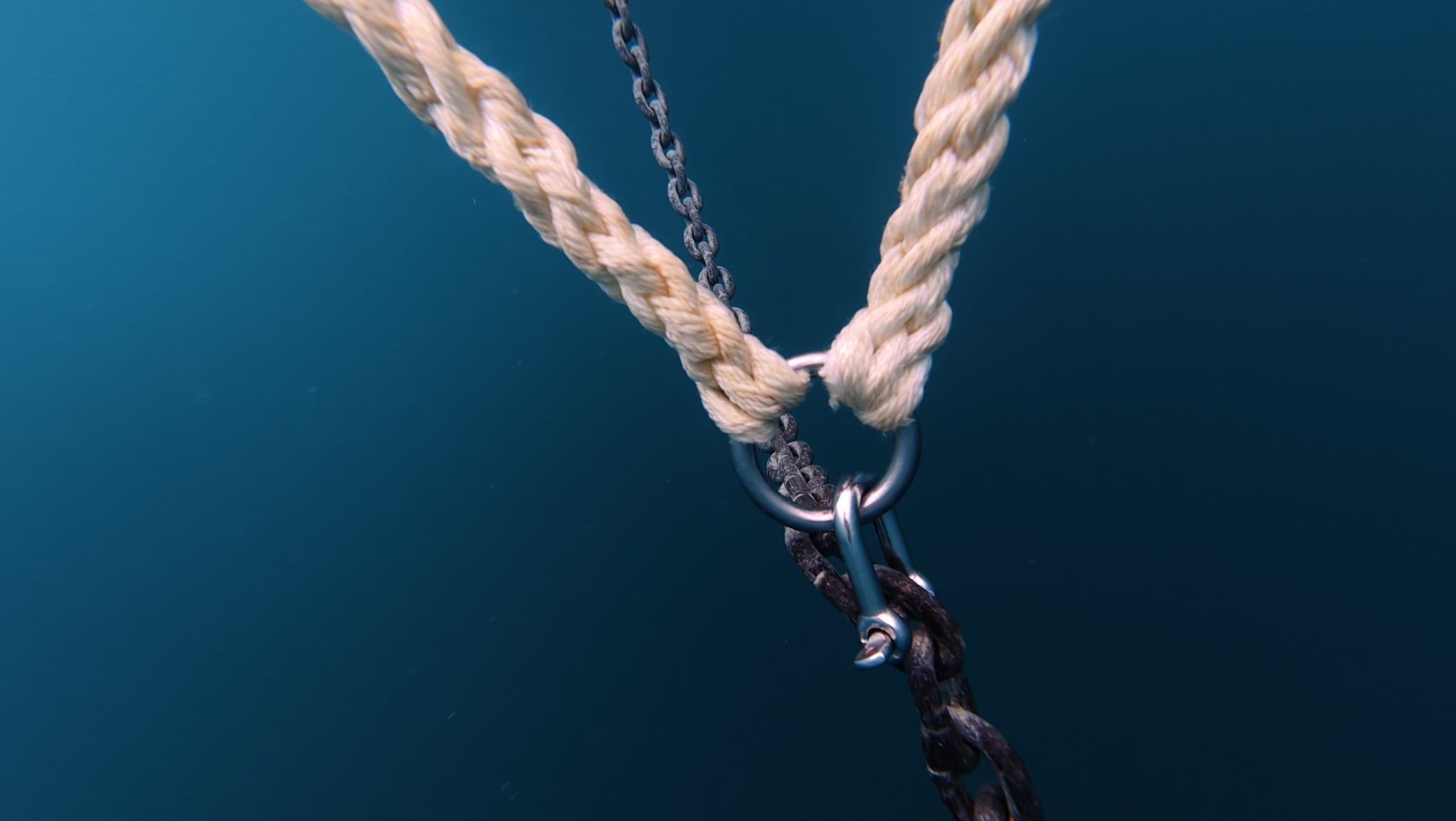

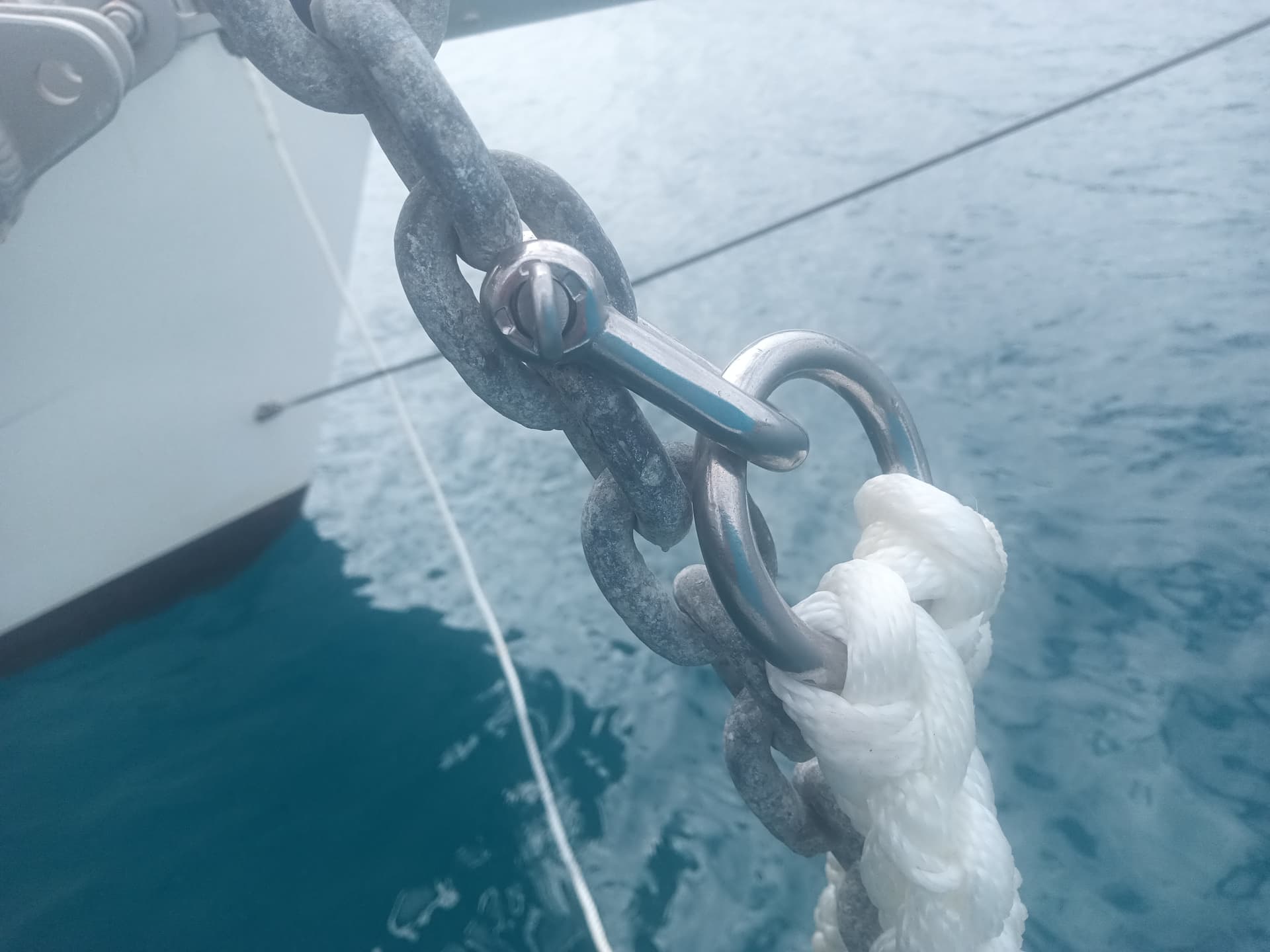

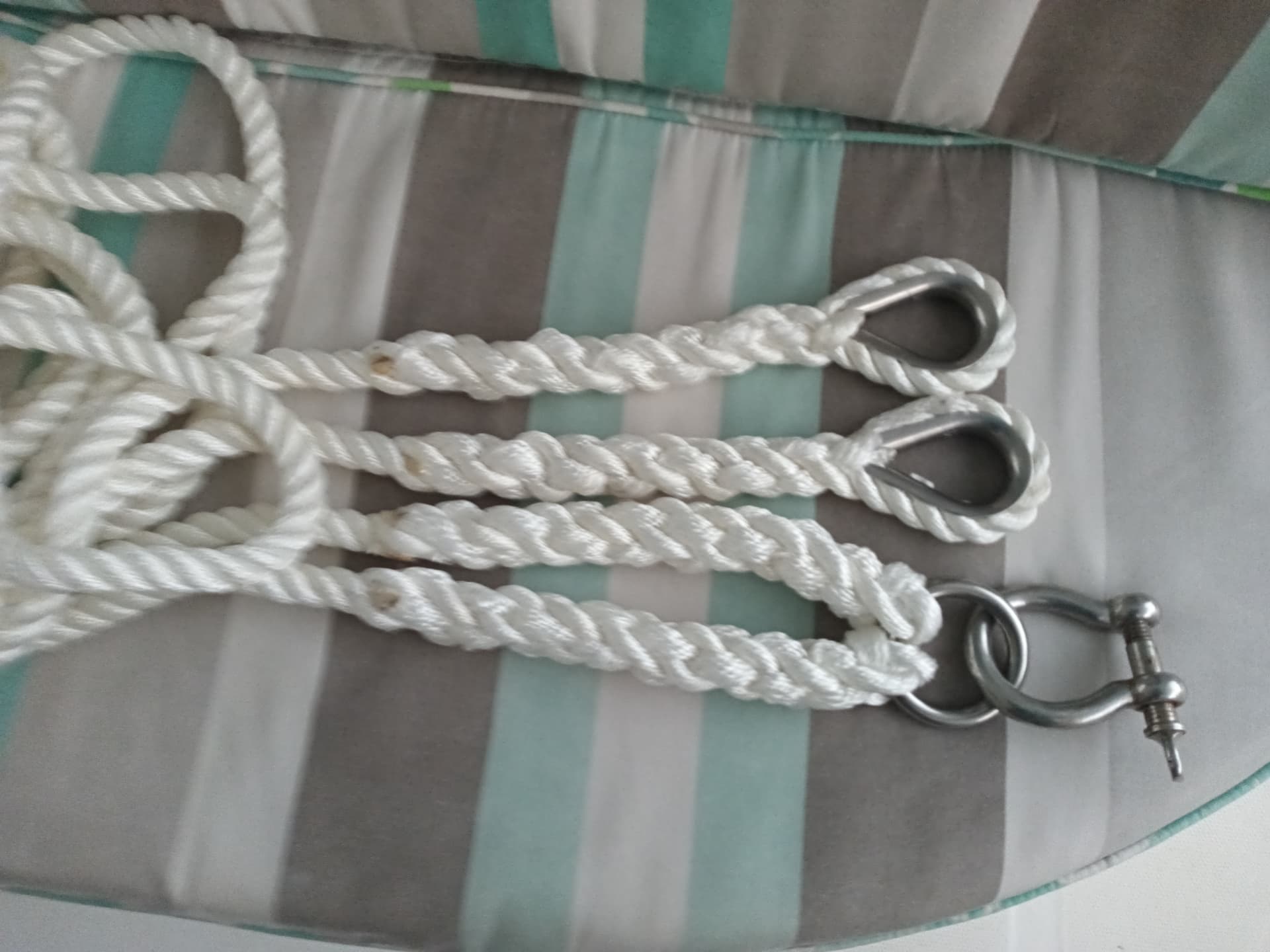

Ok, none of the hook or clip options I’ve tried really work. For the past year or so we have been using a shackle through the chain. I’ve made a new snubber that removes the hook. It just has a ring for the shackle. The shackle in the photo is not the size to go through the chain..
This system is totally simple and strong. We have been on a storm at anchor with 60kts of wind … Both engines were running at 1800 rpm too. Yes of course it was at night :joy:

What is the working load of that ring?
The ring is a certified 2500kg ring. The D shackle is also certified. No wiggle room for an insurance claim… And we are the ones that have to sleep at night on anchor.
It’s 10mm chain. The chain is weaker than the ring. Some anchorages we use are very shallow. If the snubber bounces off the bottom, most connections come undone. This won’t.
I’ve had a ring like that, used in a dinghy lifting harness, break at the weld. Monitor it regularly.
A dinghy only weighs a few hundred kg at most. If a ring broke while lifting a dinghy, I’d be extremely concerned about the supplier of the rest of your rigging. For a ring to fail with a load of only 150kg, there must be an explanation. I would be replacing any rigging I got from the same supplier.
I would seriously dispute that a certified 2500kg ring would break lifting a 150kg dinghy. Perhaps you didn’t have a ring like that.
Perhaps you can compare the thickness of the ring to the thickness of the anchor chain.
There’s a huge difference between a ring’s working load, and the shock stresses that constant loading and unloading place on a weld. And, since this ring will be submerged, it will be subject to pitting corrosion. If it’s going to break somewhere, it will probably be at the weld.
My only suggestion is that you monitor it on a regular basis. One needs to learn from others’ experiences, because if it happened one time, it will probably happen again.
