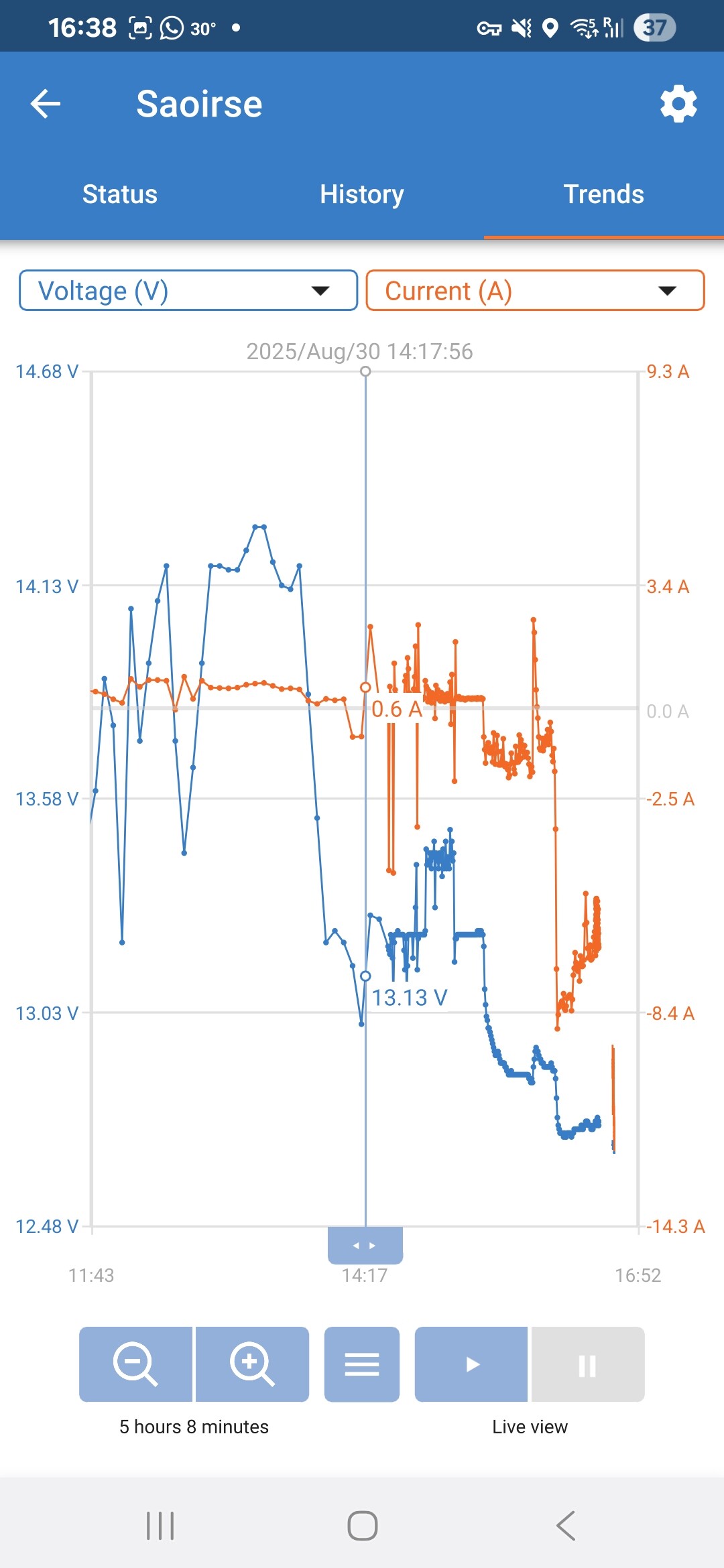

So… the windlass was serviced and worked fine (all within 24 hours). Boat is on the hard with chain and anchor dropped. The windlass brought the chain and anchor up without issue. As workmen are leaving, behold … windlass not operating … probably 60mins in between. They are finding a draw of only 9v in to the windlass. All this time shore power is connected. The batteries were checked and the digital feedback was they were below a threshold and should be replaced (thinking 580 clicks out of 1,000 … I cannot remember what the numbers were). When I said I wanted to replace with lithium soon, main man said that they should be ok for the 6 more weeks in the water. During the period that the windlass was operating, the battery voltage did not drop below13.2v and I have now turned shore power off and voltage is 12.69v (runnig from solar)
