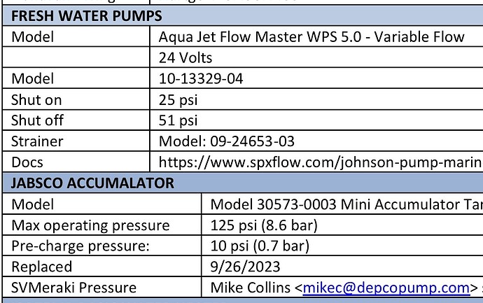

This is the pump set we have installed by KYC on BAHATI. Recently I replaced one of the two pumps with a new one.

On our boat (500se) all the pipework is JG Speedfit. For a hot water system it’s rated to 6 bar (87psi).
So as far as I can see and assuming that you have JG too, the pipework should not be the limiting factor.
If you do change the psi rating of the pumps you may need to adjust the pressure in the accumulator too.
Hope that helps.
