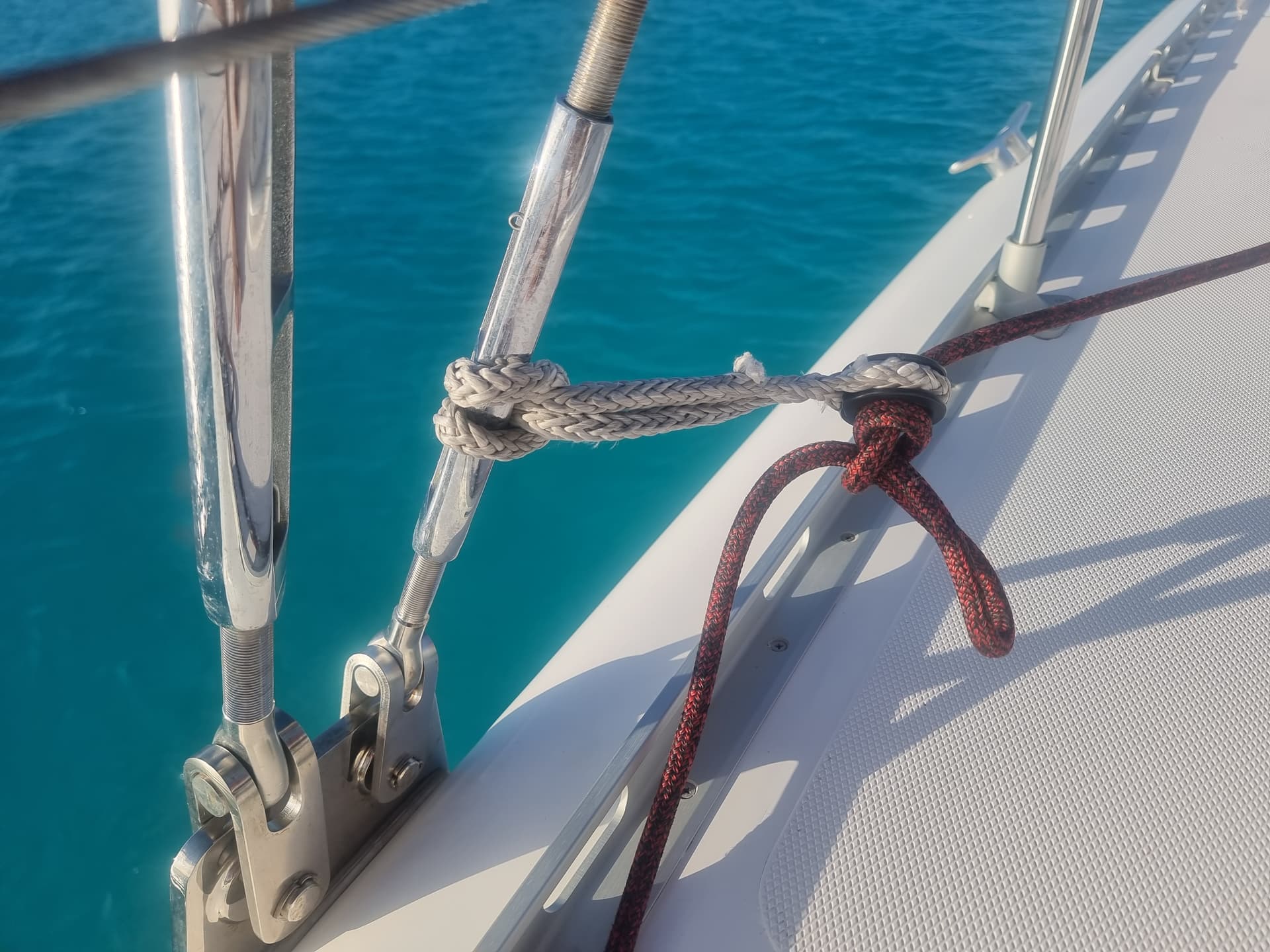

We don’t use a barber hauler as such - just low friction rings cow hitched to the Cleat oy the stays.
If we are going to be on a long passage with a good chance of downwind sailing, we do add a second lightweight set of sheets set up for our low friction rings - on addition to our normal Genoa sheets. We can then swap from the normal Genoa sheet to the wide sheeting angle easily.
One downwind setup we used I’d Code-G to one side and Genoa on the wide sheeting points on the other.
