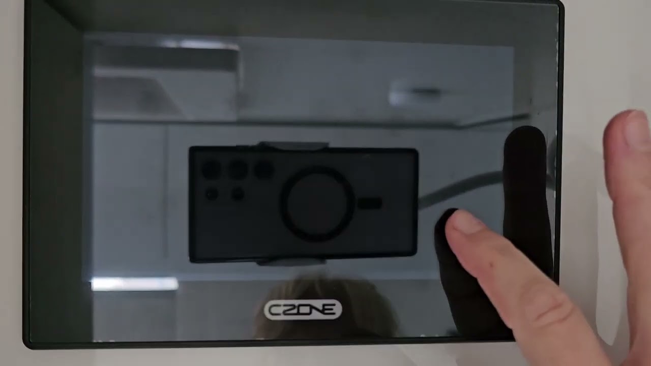

I just searched YouTube and found this basic video. It shows the converter can be controlled by Czone at 7:45 minutes in.
You’ll need a PC to configure your Czone.
Thank you Pete. Unfortunately she is only showing how to use the CZone that was probably configured for her at the dealer. I know how to configure it and set monitors/etc. I’m just not setting how to configure the MasterVolt in the CZone Configuration Tool per the documents.
But it does shows that you can do it in the video so will keep researching knowing that it can be done.
