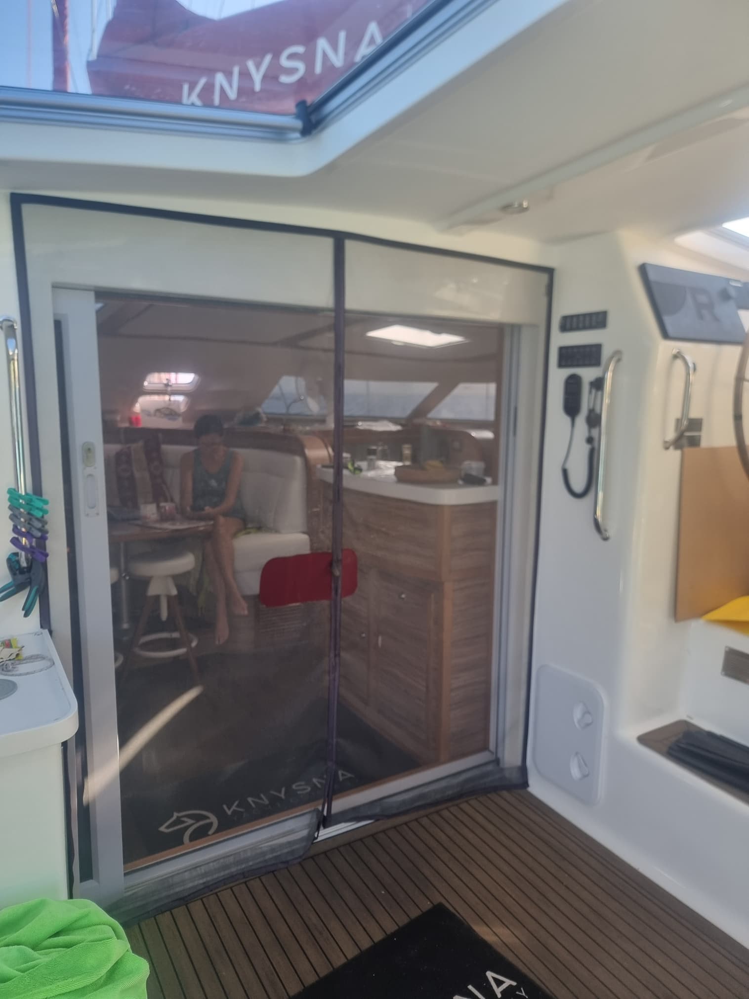

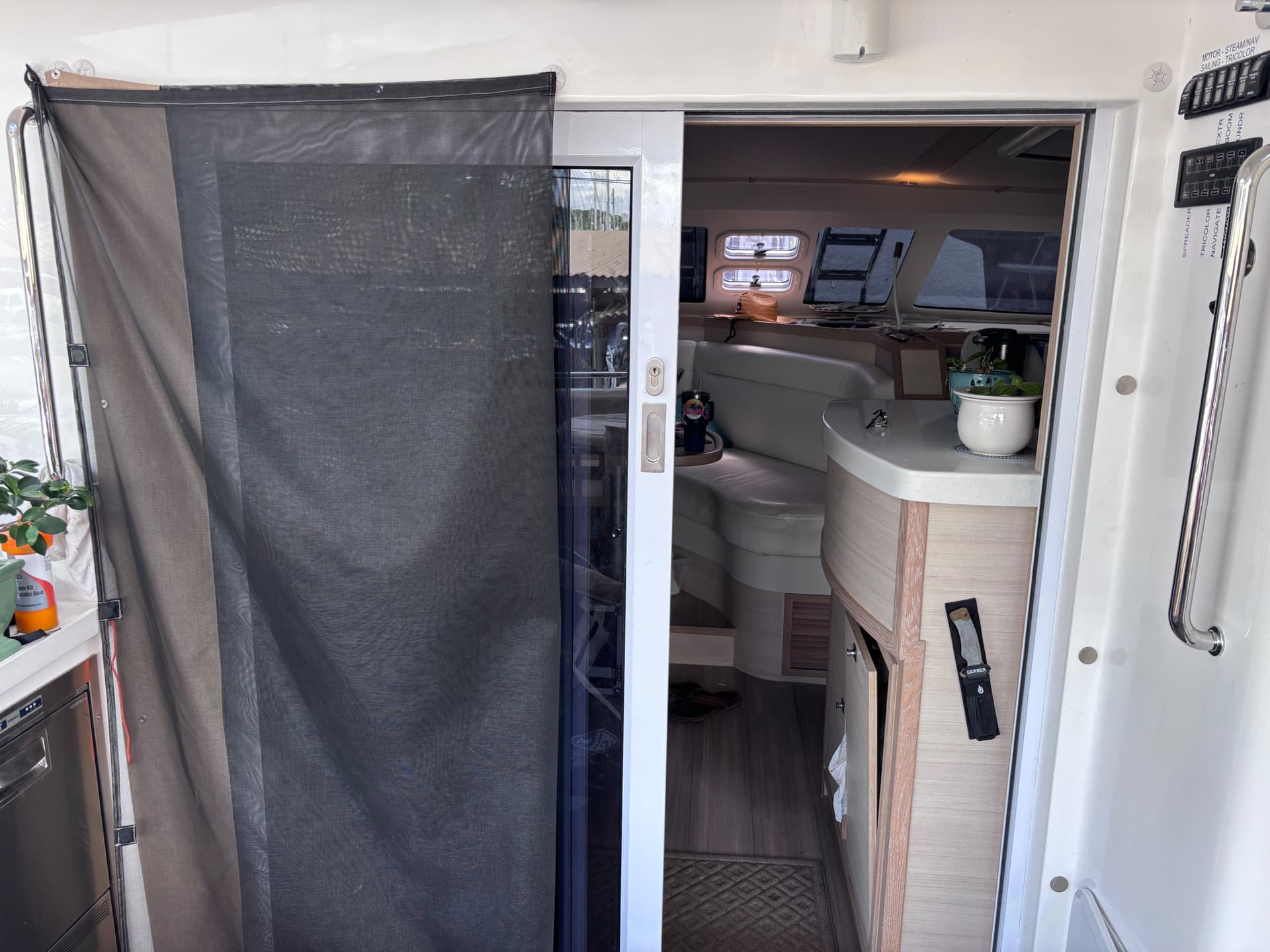

For our main doorway this is what we came up with just before we headed into the rivers of the Amazon. Its magnetic closing fly screen. Plenty of choice on Amazon around $50…
We liked it so much that it has been in situ now ever since and keeps both mosquitos and flies out of the cabin. Combined with the fly screens on the opening hatches the boat is almost bug free.
You can get them made to measure - but we did not have time. The important dimension for the purchase is width - we folded and adjusted the length. It takes a couple of trials to get the perfect length - we left it pinned for quite a while. The trick is to get it to just brush the floor in the middle and be a bit longer on the outer edges. The top edge is also not quite straight (per instructions) to aid the closing action. We went higher than the door opening to aid with the opening of the gap.
The burgundy patch in the middle is just sunbrella bonded on - as a opening plate - ours started to get a bit worn there (Tip… Don’t walk through the screen with sharp cutlery point first! :rofl:)
Its over two years old at the moment and going well - but I guess will need replacing next year.
We also fitted a second similar screen inside in the owners cabin on the bulkhead doorway - only used if we are in a dengue/malaria area..

Great, and thank you for the photo. This is what I was thinking would work. I will look on Amazon when we get there. I love the Sunbrella patch :rofl:

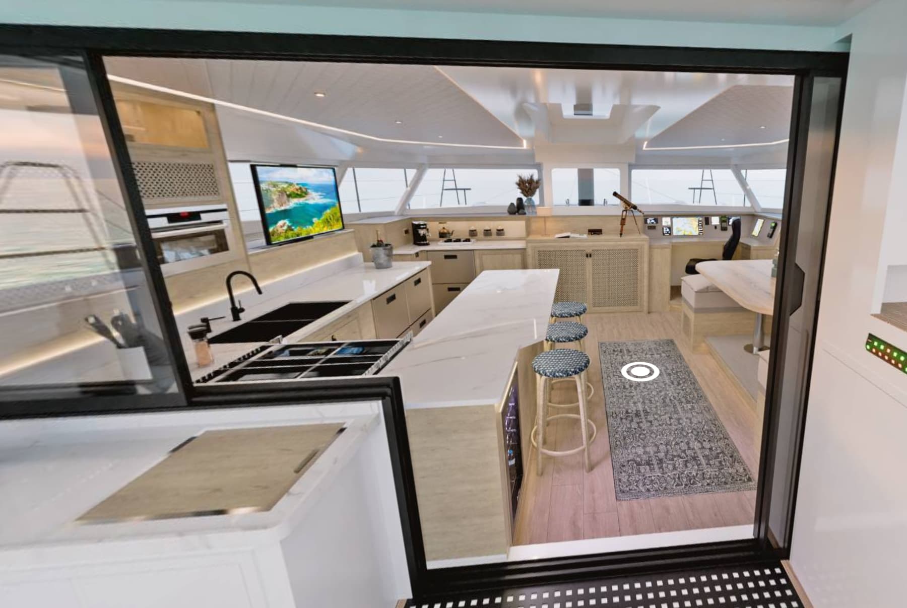

Thinking about it you are getting a 550 which I believe has a different layout around the sliding doors/window. Looks to me like it will be a bit more of a logistical challenge for a permanent screen.
Yes it might be but I at least know what works on the 500’s and can go from there. Isn’t boating always new challenges🤣

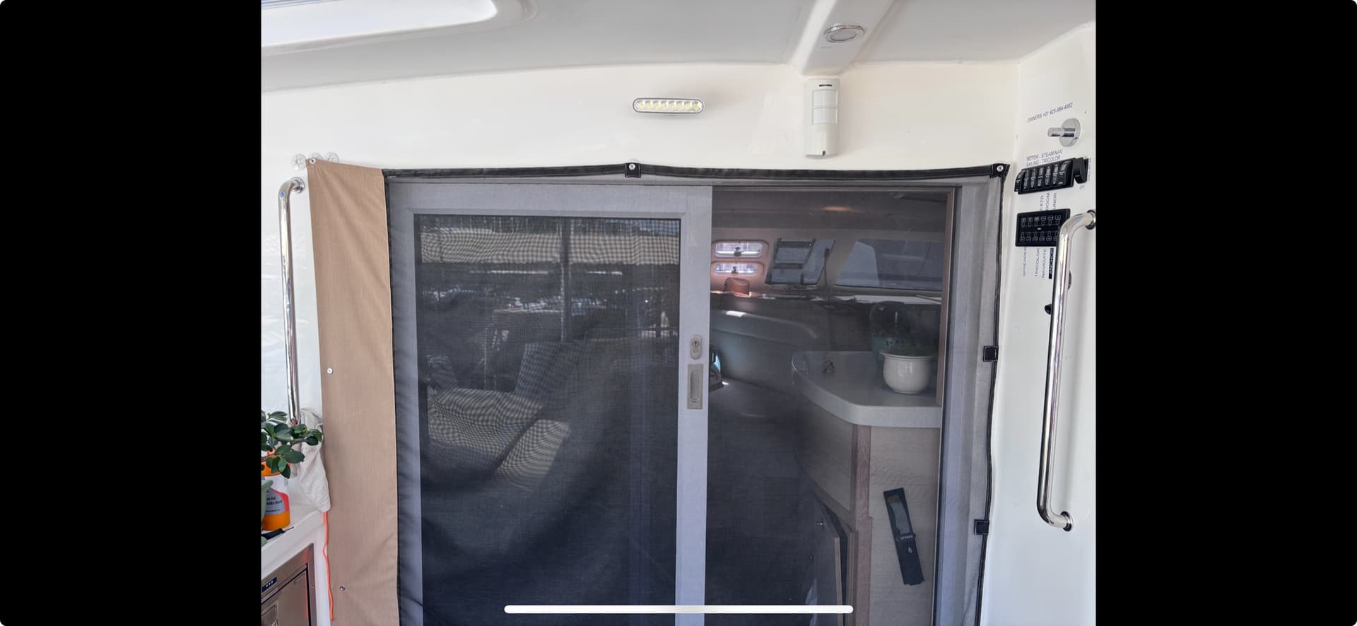

Hi Ann!!! I LOVE this. How do you attach the screen to the boat? Planning to order this for my next trip home.

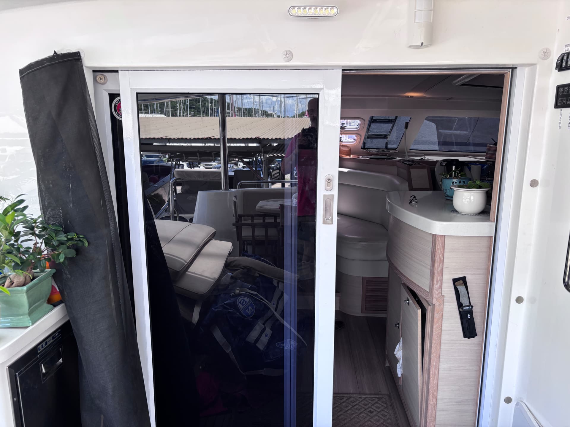

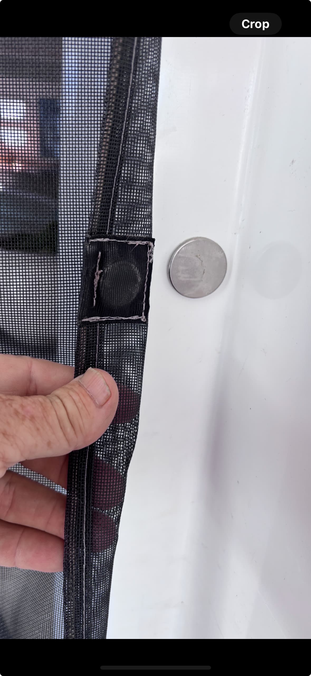

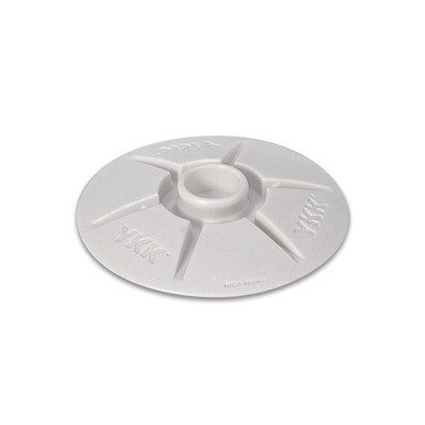

We use the domed studs with snaps to attach ours to the bulkhead.
Note the three attachments on the tip left, pin the left permanently, pin the right side, or pin the center when you want everything out of the way.
Can buy magnets on Amazon. Carolyn sewed them into the screen.
That was what I was thinking too and they last and don’t fall off easily?
We just used the adhesive Velcro that the screen came with onto the gel-coat. Wiped down with a solvent first to remove any oils etc from the surface and it’s been good for two years. I would do the same again as nothing too permanent.

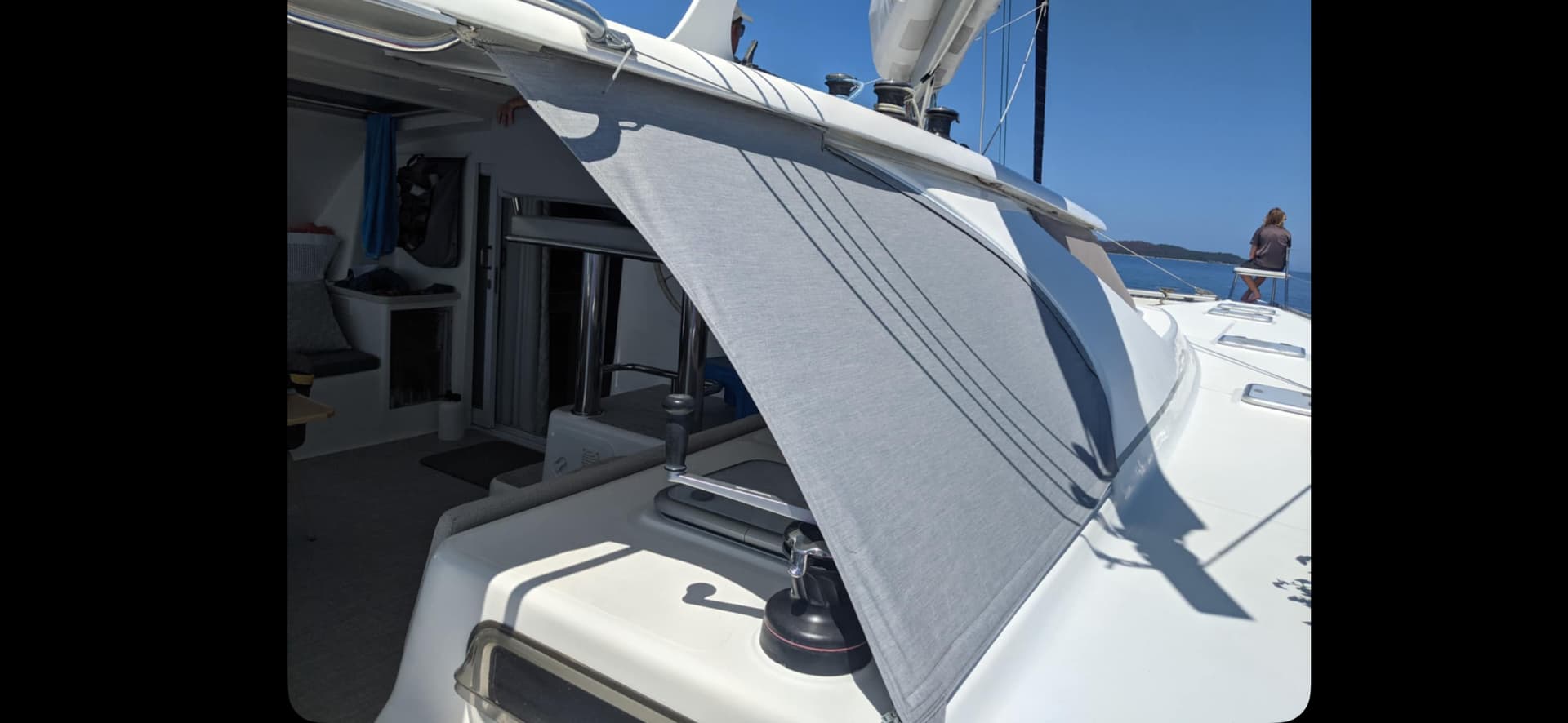

Sue, we ordered custom black out blinds for cabins but we do not have in Salon. However we have exterior window shades that snap on to exterior of salon windows. From the outside, you cannot see, but from the inside, you can see out. It helps with keeping cool. Kynsna provided this, it works great
