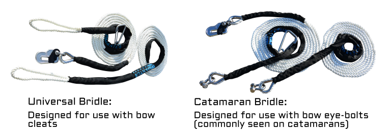

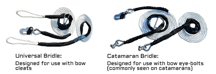

I understand that the Mantus system is now being supplied on current builds. Attached chart shows dimensions.
