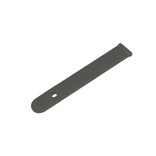

It sure is a beast … That said I prefer there M2 hook … except for the awful rubber strap locking system which I replaced with a velcro strap which last between 3- 5 months and then i just replace it with another one and then redo the velcro on the old one and its good to go again! … Just make sure you rotate the locking pin correctly as it looks like the same locking system they use for their mooring ball bridle. Now that i think of it you can now probably use your M3 for both your chain and mooring ball … which is a bonus!! We really like the mantus products and lots of their stuff.

We use to have the hook with the rubber strap. We (I) never had any problem with it, but Carolyn did as it was hard to wrap and hook it in the post.

I recently purchased a couple of spare straps for our M2 chain hook - at a very good price for a marine product.
