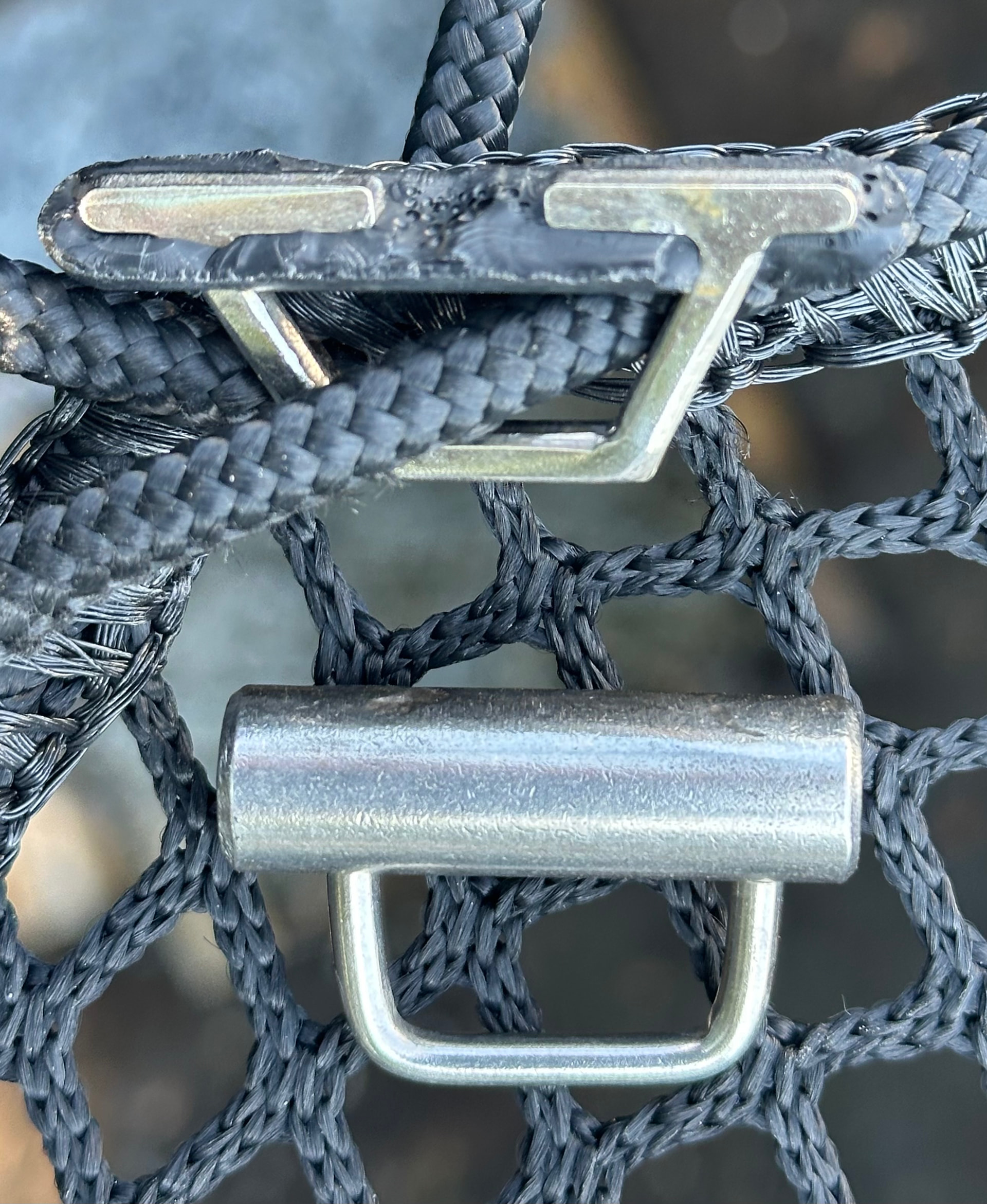

Some of the trampoline slides that were provided have plastic slugs, and the attachment point has square edges. The plastic slug is failing, and the square edges are chafing the line.
To fix this, I purchased 7/16" Stainless Steel Round Base Slides (part VSRS7Slv) from Sunrise Yacht Products, which are solid 316 SS, and the attachment points are round SS. These just arrived today, and are solid.

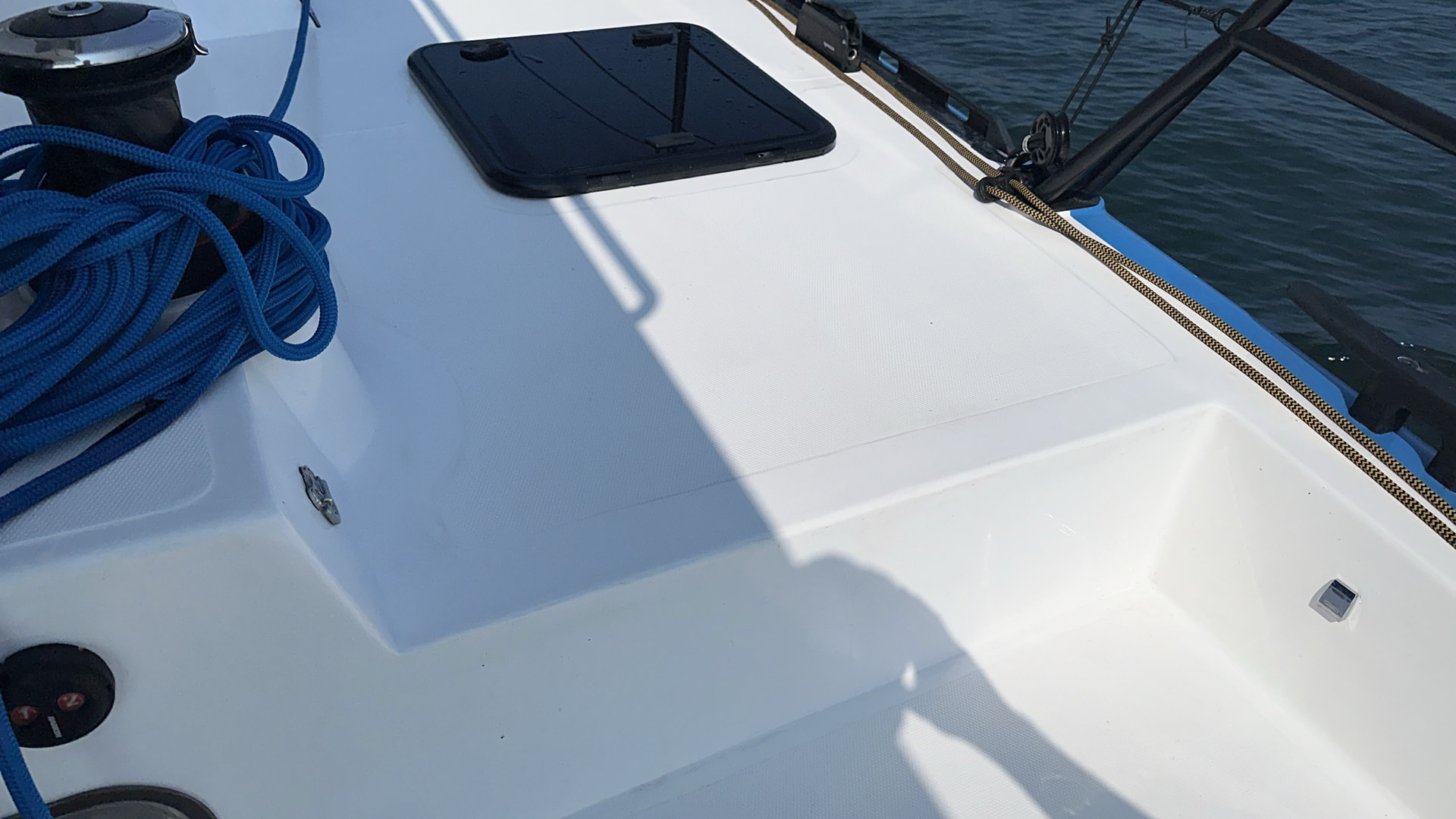

The gap between the diamond non-skid and the edge of the top step is around 90mm. All of the other steps have 25mm. This makes for a very slippery spot, right by the stairs. I slipped on this the other day while washing the boat, and got quite the bruise on my butt. I’ll spare you the photo of that! :rofl:

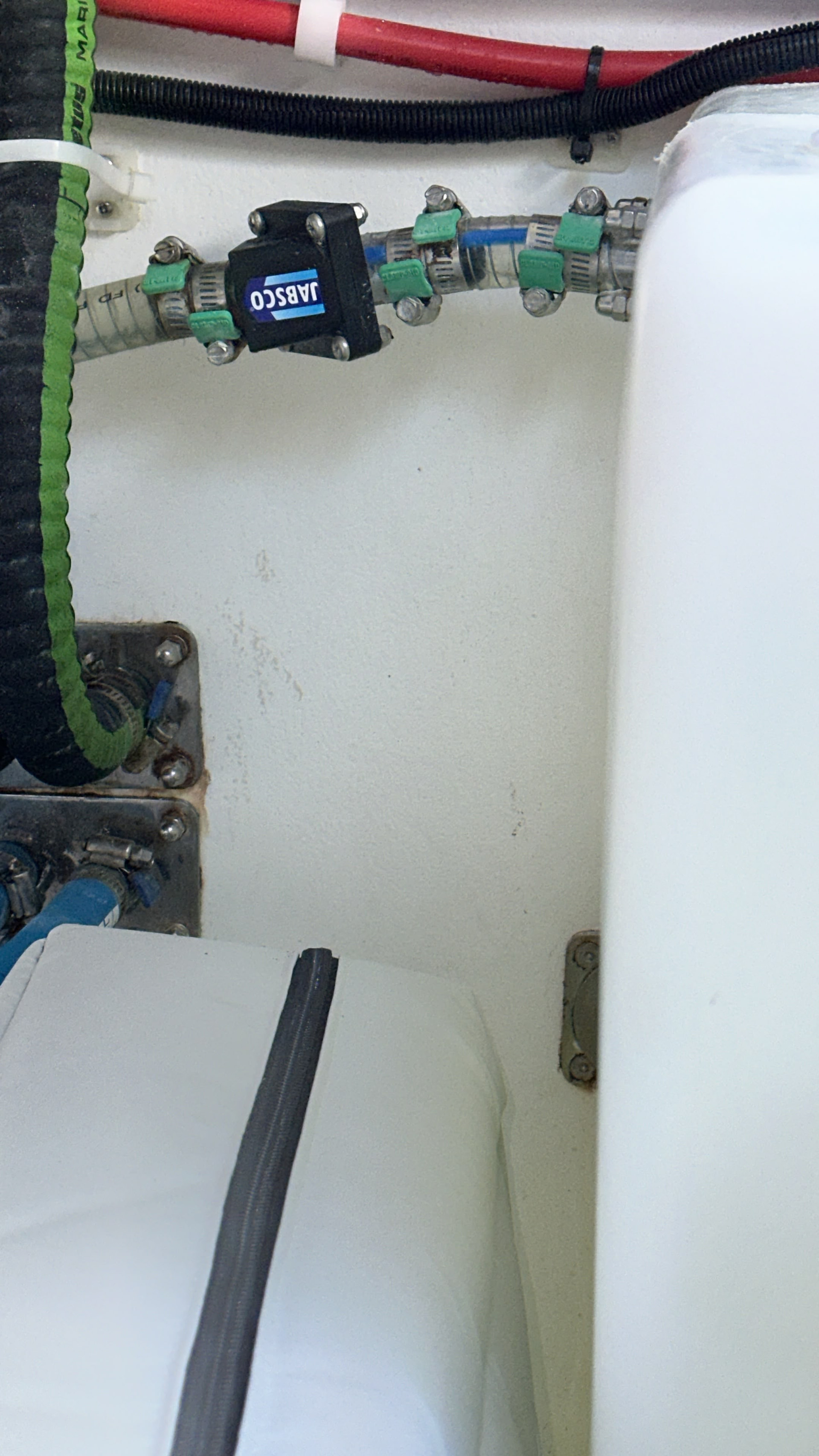

mount the water overflow on the top of the tank. You lose about 6 cm or 9% of the capacity of the tank by mounting it where it is.
